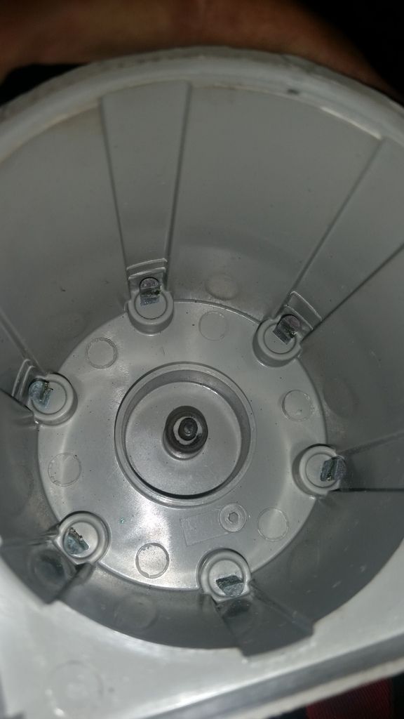

    [IMG][/IMG]
    I also believe this may be ignition related due to the way my terminals look. Theres a bunch of build up, and it got there over a pretty short period of time.

    I would check to see if it's timed right, cap and rotor seated correctly and fuel pump pressure under load. Guessing weak fuel pump making engine run lean. Or clogged up injectors/fuel filter.

    Removing the dizzy requires a crows foot wrench. Access to the hold down bolt is pretty tight. It seems to me that dizzy removal is a good "gate keeper" for these trucks. If you can't get the dizzy out odds are the rest of these touchy difficult trucks is going to throw you for a loop.

    For the dist I use a 1/4 drive 9/16 wobble socket on a long extension. Works like a champ. Lot of stuff in the way down there. I've also used a short 9/16 box. No fun. Funny story here. When I first bought my truck I went to set the timing and the dist was just sitting there. The hold down was just siting there loose.
    You need to pull down the ECM (behind the glove box) and take the cover off, if the you see a blue cover it's a stock chip. With the mods you mention I suspect it does but you need to find out.
    Find a different auto parts store and find some heat sink compound and put it under the ign module. You can do this without removing the dist. Some of your symptoms jive with an overheated ign module.

    If you can screw both dist cap screws down then the cap is not on wrong.
    How did you change the knock sensor without removing the dist? Probably not your problem in the beginning but probably is now. If you screwed the knock sensor in tight then it's probably seeing non existent knock and may be part of your problems. It has to be torqued to a specific torque. 14 ft/lbs Do not use any sealant, only what it came with.
