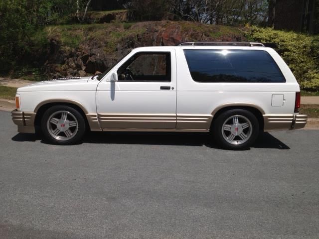

          Brought out the Blazer for the first time this Spring. Seems like a long time in storage.
          Now it's time to get to breaking down the top end and replace everything from the head gaskets up including the brand new CPI intake I acquired this past winter. The old CPI intake was corroded at the water jackets causing antifreeze to undermine the intake gaskets and seep into the motor oil.
          On a side note, I also pulled my 1973 Z28 out into the sun. I've owned it since 1989 and it's a great car. Haven't had it on the road since summer 2006 while I've been spending time & $$$ on two other projects, including the Blazer transformation.[IMG][/IMG]
          4.3 CPI, 4L60, Dana 44 3.73, ZQ8, Work-In-Progress
