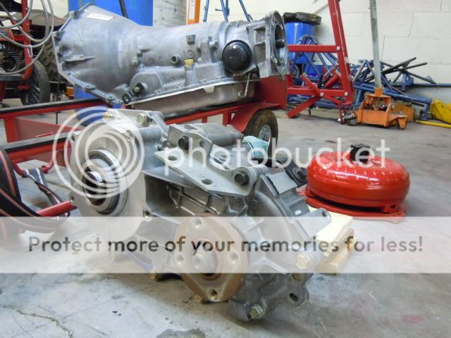

Re: scared about tranny, for launch
mine went into the mid 11s. before it let go. Cheap EBAY REVMAX Conv pictured came apart causing the failure!! Be caeful or the picture will look firmilar!!
