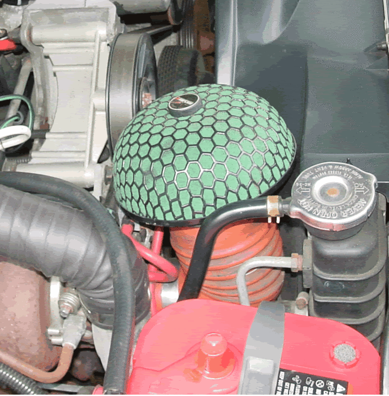

could i use my stock elbow (orange) , and a K&N cone?? or isnt the elbow stout enough to support the weight?

You need more space than that... unless you plan on running without a hood. The cone filter won't fit pointed straight up. If you've relocated your battery, you might be able to make it work with those parts alone, but I'm not 100% sure on that... its been a few weeks since I looked that over in my truck.

I had mine that way for a little while until I deleted a few things and made more room.. But if your going to go this route there's very limited room so the filter would have to be small or shorter then a normal cone filter.

That's what I did. You will need a short 3 inch O.D. adapter piece to clamp the filter to the orange elbow as well as to provide a bung for the PCV on the passenger side of the truck:
The end of the K&N tucks right into the "hole" in the fender...

That was the way I had mine, and had my battery underneath, but I couldnt get my battery secure enough so I bought a very small filter and had it pointing straight up from the orange elbow.
Right now im working on doing something like this for my battery so I can switch back to that setup.

That short K&N....anyone have experience with it? And what about the hose that connects to the long airbox...can it be plugged or rerouted?
And the OP should know it looks like the battery has been relocated in several of those pics.
