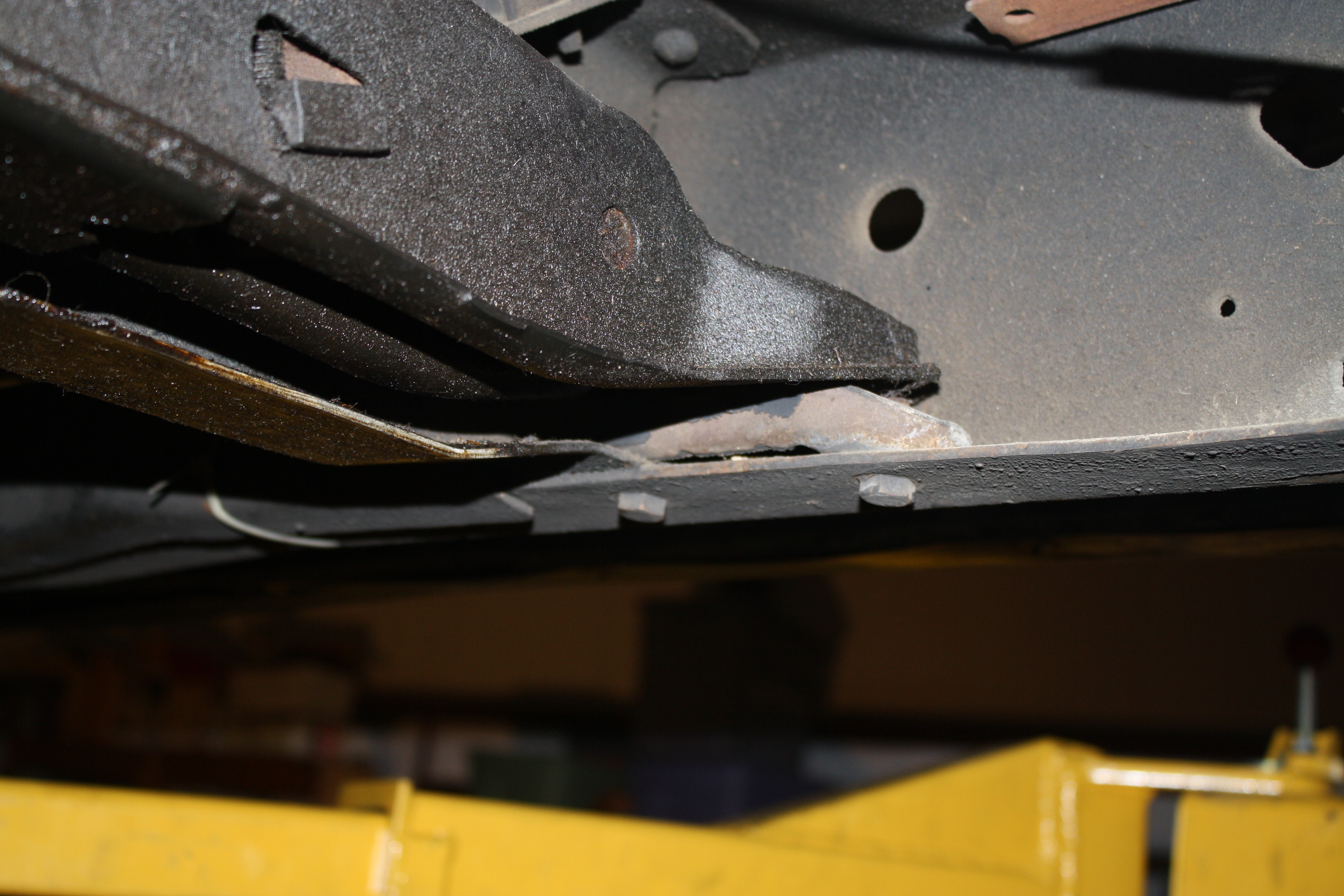

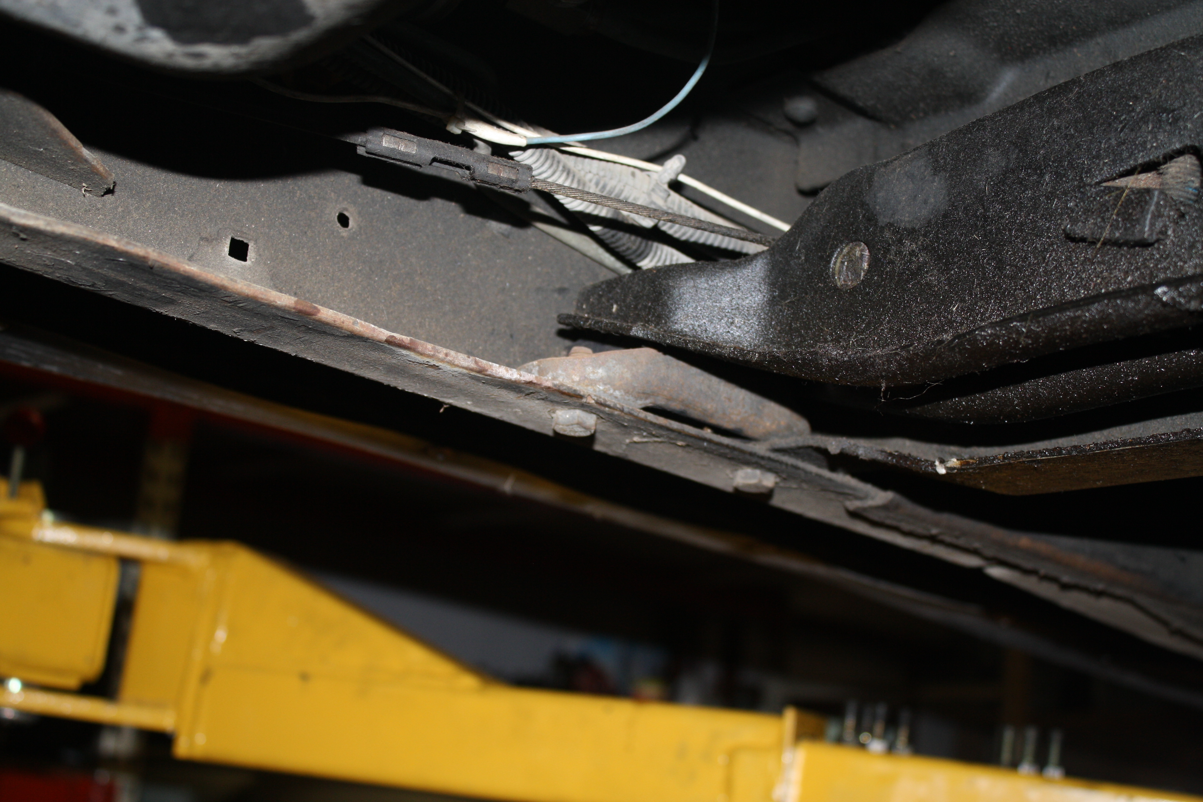

There is a serious buzz in the truck from about 1000-1800 rpm. I put the truck on the lift and discovered that the passenger side torsion bar is sitting on the crossmember.
http://oldpizza.net/images/syclone/IMG_3278.JPG
http://oldpizza.net/images/syclone/IMG_3279.JPG

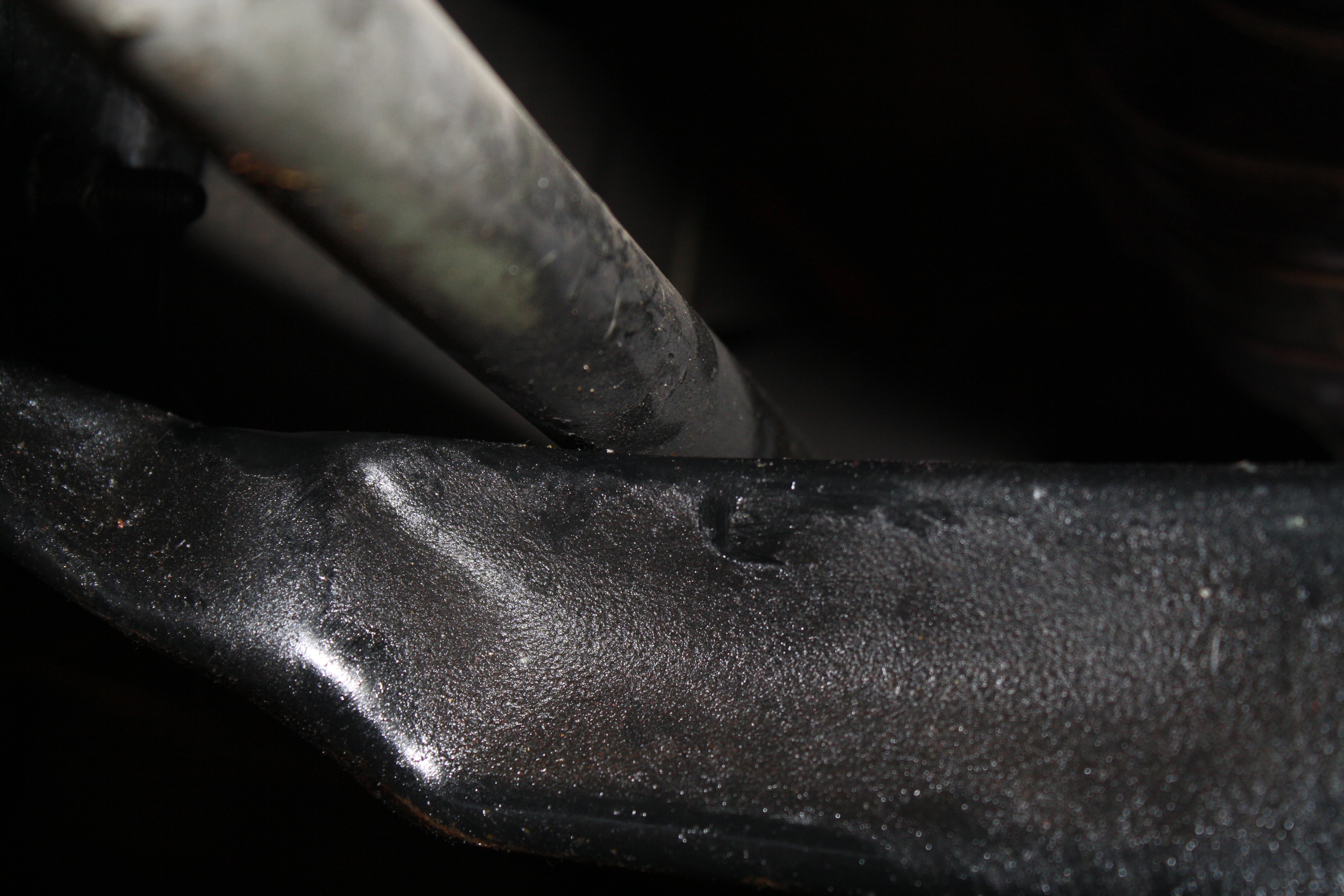

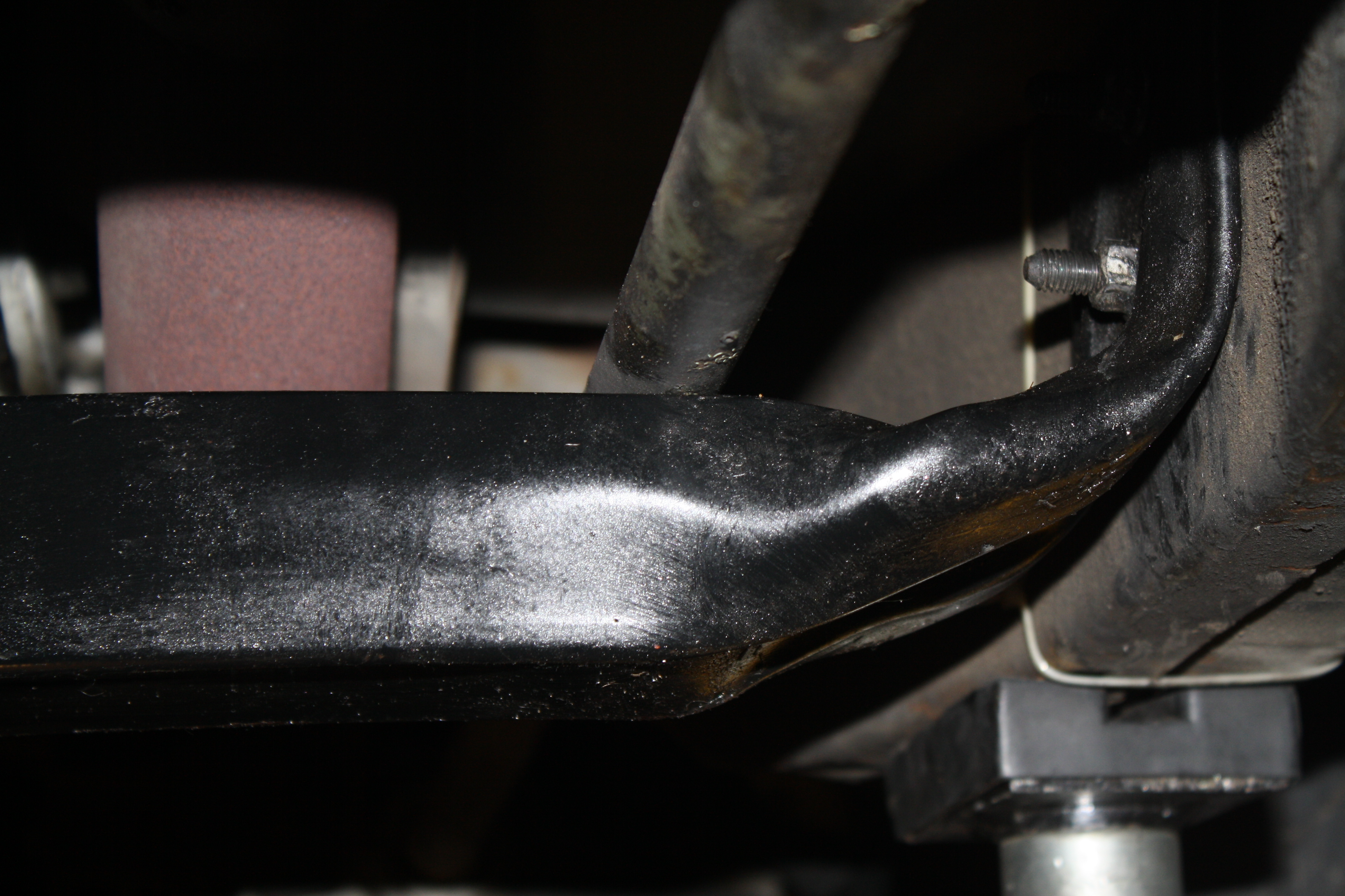

I then started looking at the torsion bars and the back end of them. Are these mounts supposed to be higher? That would pick the bar up off the crossmember.

Re: How big should this gap be?
i think it might be that way since you have it on a 2 column lift? and the wheels are hanging way down
syclone1452
<smacking forehead>
Of course!
I'll put it on the ground and have a look
Thanks... can't believe I didn't think of that <shaking head>

Those mounts probably need to be replaced. They are most likely sheared. Try prying upwards on the cross member with a big pry bar. I bet you can lift them. But I don't think these are the source of your "buzz".

I put the truck on the ground, and there is about 1/4 inch between the bar and the crossmember.
I started the truck, and it still has a vibration...even at idle. I put the truck back in the air, and discovered the transfer case is rubbing on the floor. A really close look at the crossmember shows some marks on the bottom.
Hmm... I wonder if my truck as a story to tell?
Can I bend that crossmember?
How low should it hang?
Will a normal 4x4 or Bravada crossmember work?

I bought a new GM crossmember locally. I removed the original from the truck and put it next to the new one. The difference was quite small; I actually didn't see any difference. I was a bit sad
I installed the new crossmember, anyway. The passenger side torsion bar is now about 1/4 inch farther away from the crossmember. The transfer case is now about 1/4 inch from the floor.
Mission accomplished!
I put the truck back on the ground and started it, There were no vibration noises.
