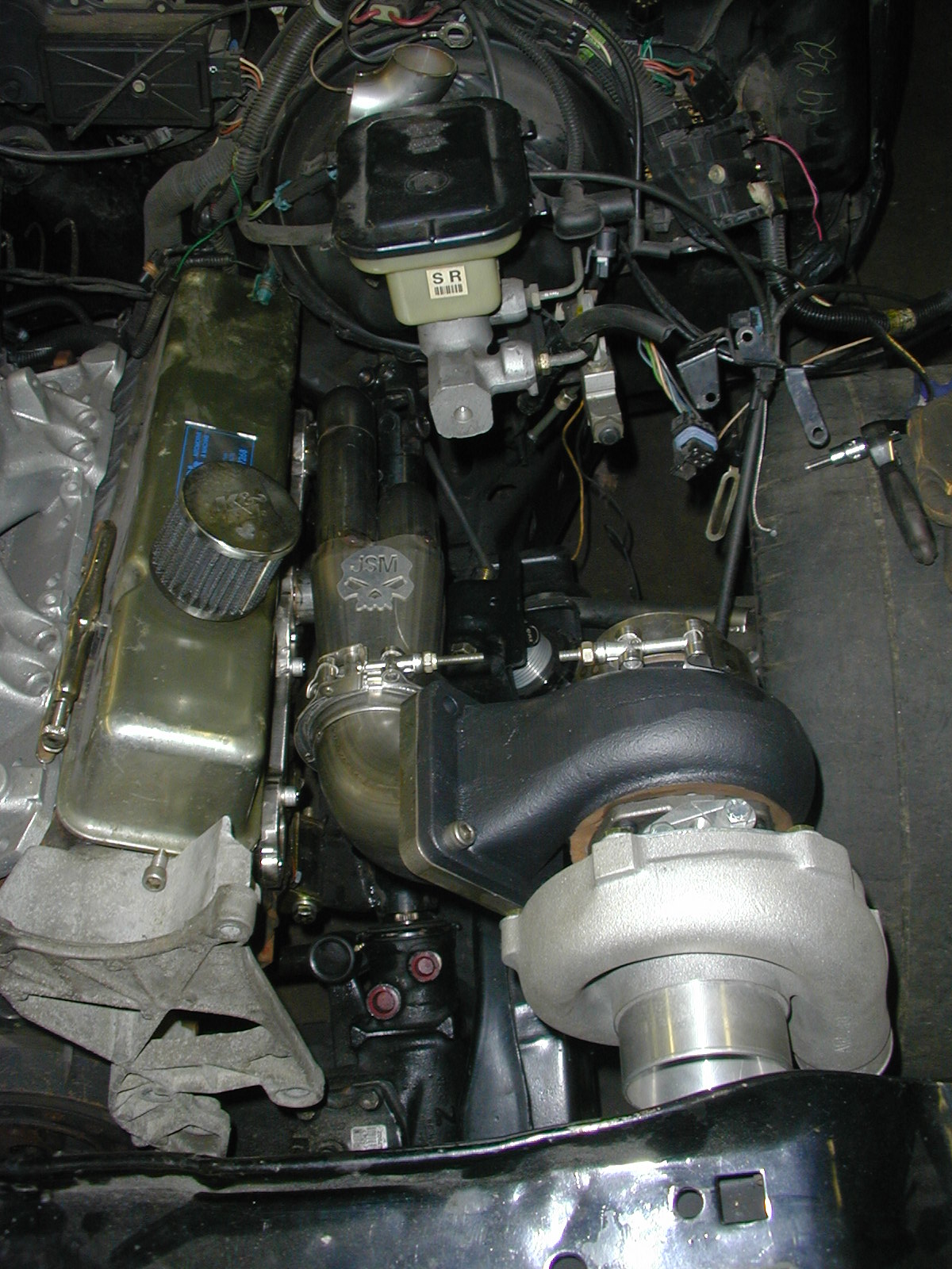

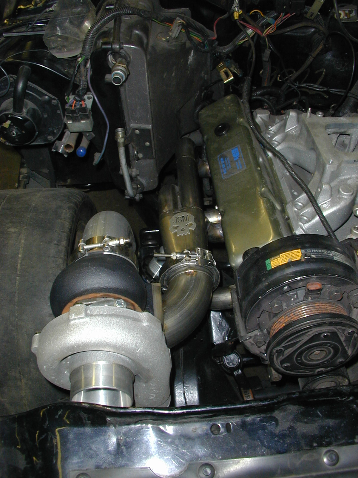

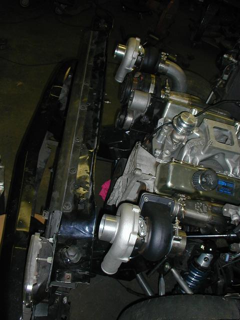

And here is a shot of some progress from yesterday. Yea, some of you guys are going to hate me, that is OK.
The build details are
  • 350 bored .040
  • Is a left over motor from old project
  • Twin GT35's
  • Twin Tial Wastegates (one sitting on thermostat if you look close)
  • 1 5.8" custom headers
  • George Blake Race 4l80e with some custom parts, transbrake
  • JSM Coilover front, but stainless steel arms
  • Custom 1 off triangulated 4 link rear
  • 13" ZR1 front rotors
  • 85# injectors running on code 59 of course
  • Frame has been blasted, boxed and painted
  • Weldon Fuel Pump -10 feed
  • Sumped tank
  • O yea, I am keeping everything AC, Cruise, 3 amps, sub this is not going to be a stripped down race car.
  • Twin Air Water intercooler with ice box

Nice! :tup: Who cars what the motor is, as long as it's boosted! and your's is x2 :drool:
Looking good! Done in time for NatsX?

Okay Your picture taking ability Sucks. I want more pictures and better pictures.
So go back out to the garage and snap some more pictures.
Go now please

Yesterday 1 step forward 3 back. The motor has a long history, one I had built many years ago for something totally different (67 camaro). So needless it isn't setup ideal for boost, but should be ok. My goal is not to set any records, just have fun and enjoy the truck anyways.
Last night Jeremy came over, motor has about 10k miles on it. Figured do a health check, etc. Pulled it all back out, leak down test. UH OH, couple bent valves. Guess SBC's don't like to rev past 7k like I would take the motor before.
Cam bearins looked good, mains not as good so going to put new mains in. Obviously heads need valve job, going to drop them off today.
Gotta go somewhat budget on this project if I ever want to drive it. So good news is nothing too expensive to fix, bad news is more than I was hoping to fix.
So Marty if I did take pics now, you would just see a SBC on engine stand torn down, shit laying everywhere. I do have a couple pics before I pulled motor though.
Here are are couple more then.
