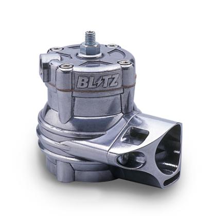

so i searched through the BOV threads and didn't find anything covering the issue I'm having.
In a nutshell the BOV is acting like a wastegate and not a BOV.
I have a Blitz Super Sound Blow Off Valve, with the vacuum line tee'd into the line going to the vacuum ball under the battery. As soon as I get 1psi into boost I can hear the BOV letting air out. If i get on the gas, I barely make 5psi and the BOV sounds like I'm spraying air out of an air compressor.
hmmm ok, must be the adjustment screw. Tighten up the screw a few turns and go on a test run. It seemed to help a little bit. Tighten the screw more and go on a test run. Better, but then when I let off on the gas it doesn't let the air out and i get the same flutter sound as if it wasn't even on there.
Isn't the pressure from the vacuum line supposed to keep the valve shut during boost? No idea what's going on with this thing but it's about to come off and get thrown down the street.

Use a different vac source, that one should have a check valve that stops positive pressure from going to vac ball.

maybe I'm just confused here... I was under the impression that the vacuum line from the manifold was supposed to provide positive pressure to the valve keeping it shut under boost regardless of how many psi of boost 1-25 etc. Once you let off the gas, the vacuum line should go into vacuum and release positive pressure on the valve and the back pressure from the turbo is then supposed to push the valve open and vent out. The spring adjustment is to adjust the psi of back pressure it takes to open the valve. Have I got it all wrong, and the spring tension is what keeps the valve closed during boost???
Re: Bov bs
You have it right. Any adjustments on a BOV are usually to set how fast you bleed your pressure off. I would try a different BOV. I use the TurboXS RFL and never had any real issues with it. Did you check the condition of the line running to it?

The line itself is new and good. I'm gonna pull the BOV apart and see what's going on. It's almost as if the pressure from the vacuum line isn't going inside the bov to push the valve down. Seeing as it starts to leak at the first sign of boost. So there's gotta be something wrong there... If it is broken, I'll just put the stock hose back on and be done with it... there's other things I'd rather waste money on than another BOV.

I have a manual boost controller with an external gate. I have the controller turned down to 10-12psi, and was making solid boost before the BOV so I don't think that's the issue... in fact, so much boost was going out of the BOV that I couldn't hear anything going out of the wastegate. Pretty convinced that the pressure from the vacuum line is not getting into the BOV to keep the valve shut.

this is the one I have...
I'm gonna pull the top of it off and see what's going on in there.... a seal or something has to be shot.

Looks like a single port to me. I googled some others using this BOV, quickly found a few experiencing leaks and describing the same symptoms, so you may be on to something.
