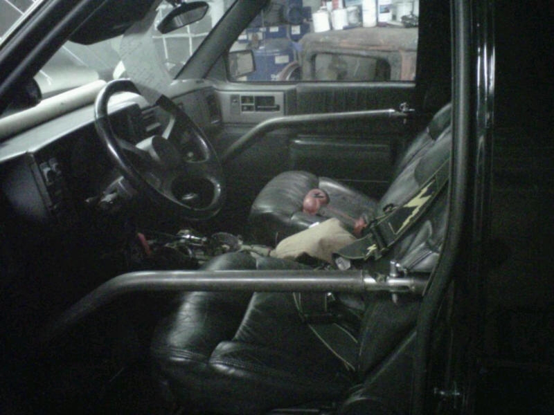

I did get a couple door bars bent up tonight, very happy with them. Thanks to John Gerber at nats, him and I spent more than 2 hrs discussing cage design and I took 90% of my design from what is done in his AWD ty.
No cutting of the door panels, no pinching your hands if you close the door using the arm rest handle either. I still have to cut the floor through and make the bottom mount.

The cage is loud, annoying, I suggest unless your building a race car to NOT do one, but hey its in and I need it to race at this point legally anyways.

What if you mounted the cage to poly bushings and tabs to the frame. Not legal? My buddy's truck (off-road) is done this way and you can't hear a thing through the cage.
JayC
Buick dude
Re: Project Never Ends
Not legal
It probably would never be discovered, tho if the truck isnt going to be fast enough to have to be certified. If its got to certify, you need to stay within the letter of the rules or they wont pass it.

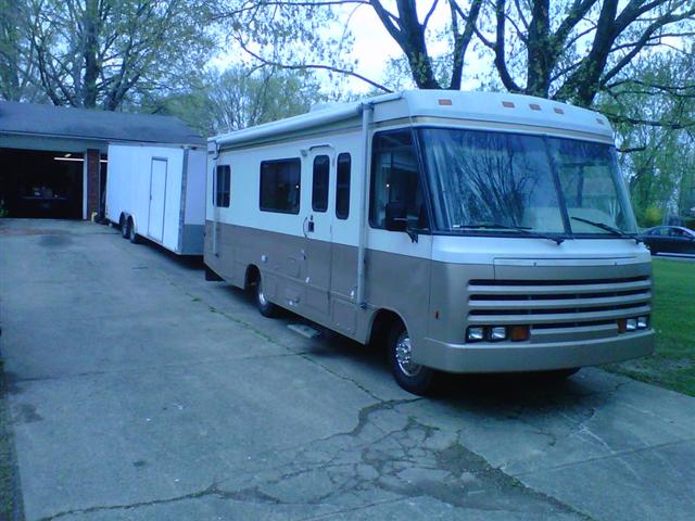

Good news is the motorhome and trailer are basically ready to go, just a few minor things to finish before I leave for the open road race.
