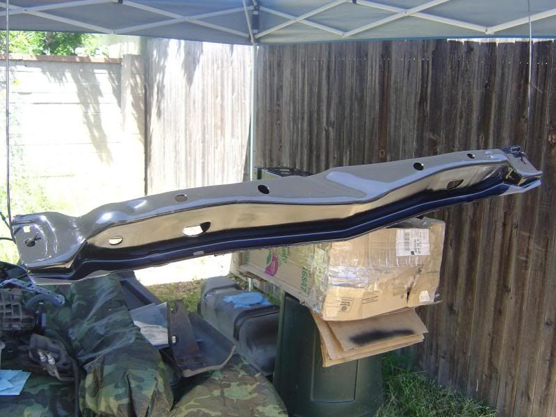

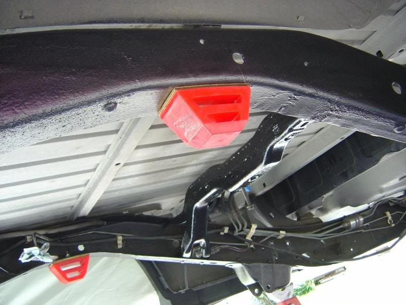

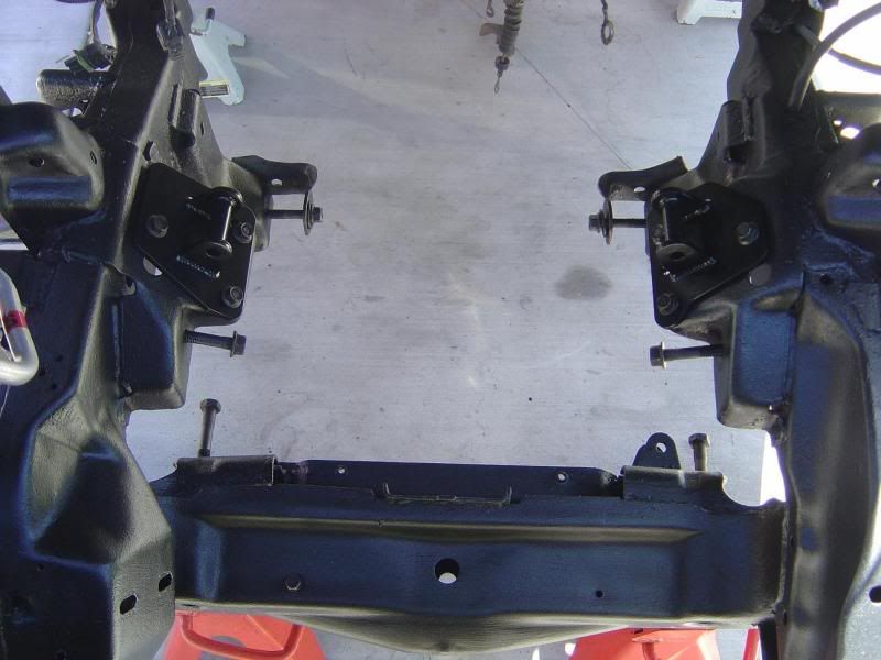

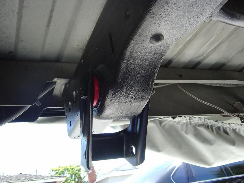

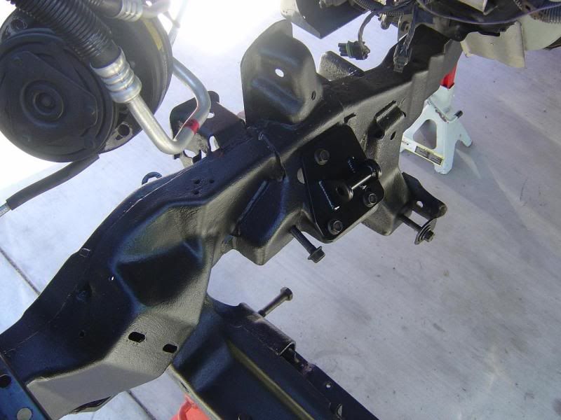

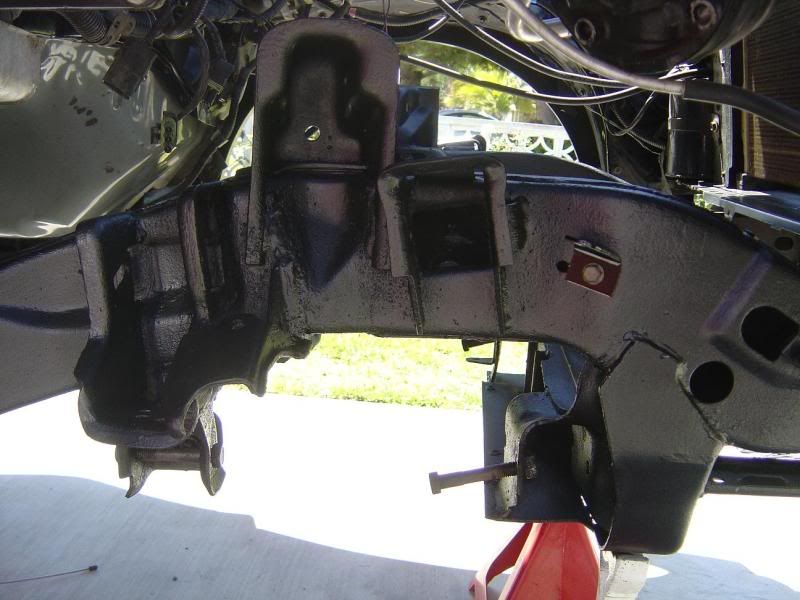

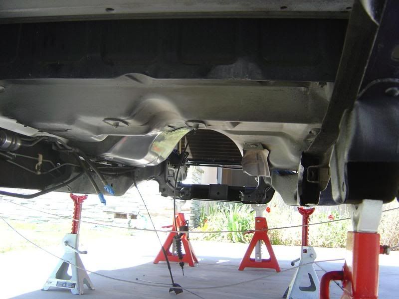

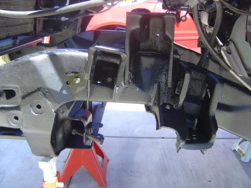

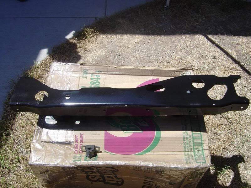

So I went to install ES body bushings and found out that I have the wrong kit:rant: So we ended up installing the rear leaf spring frame bushings and shackles, new rear bump stops, solid motor mount frame pads, and other various crap.
Here are the pics of the freshly coated frame and all thats not on it:D. I also painted the torsion bar crossmember and frame brace, so those are all ready to go. I will install the rear end this weekend and possibly the body bushings if the correct ones get here.

Paul, what PN did you get for the body mounts? You know you have to remove the metal insert on the body mounts & re-use it.

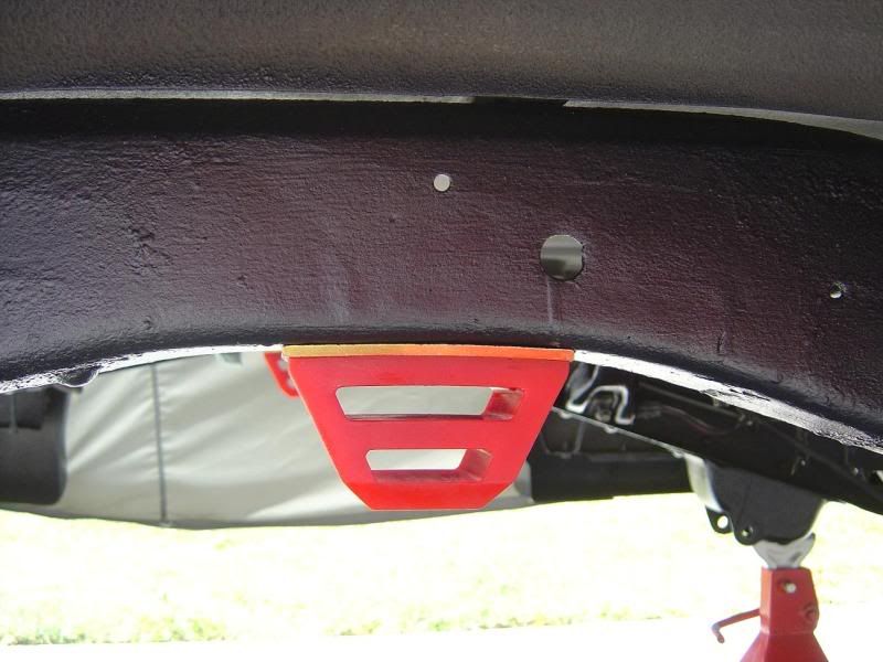

And do you have the PN for the rear axle bump stops handy?

My brain is not currently functioning. Did you cut the parts off the frame where the stock rear bump stops attach and then bolt those stops on to the frame? I cant visualize under my truck.

Rick/Lloyd,
My brother ordered the bushings for me over a year ago. He called Summit and said it was for a Syclone. Stupid summit has the blazer/typhoon part number listed under the syclone so I got the SUV kit (3-4132) and not the single cab truck kit (3-4130).
So the correct kit is on order.
The rear bump stops that I am running are part # 9-9109 and the only reason I can is that one of the previous owners removed the dropped down frame section that held the oem one.
I have no idea why, but they also cut out the lip on all four wheel cladding pieces. Maybe they once had the truck slammed and got rid of the lip and bump stop bracket to give it more clearance?? Or the thing launced so hard they had to make some extra room for things to move around :rotf: One will never know.

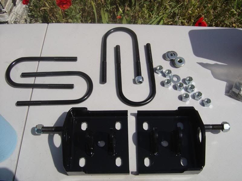

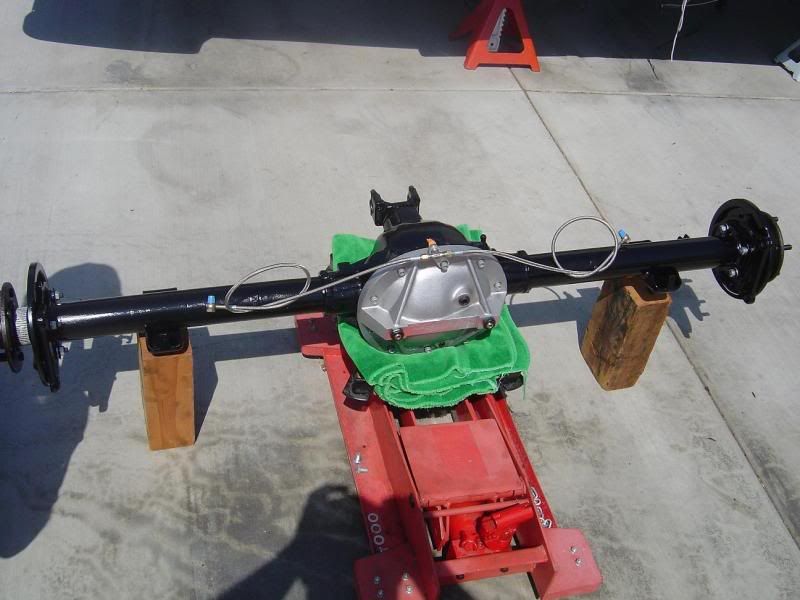

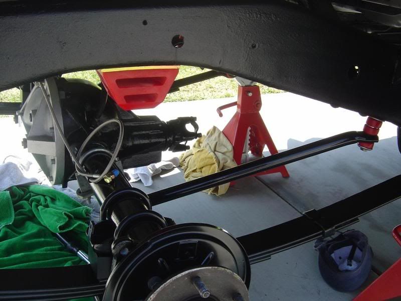

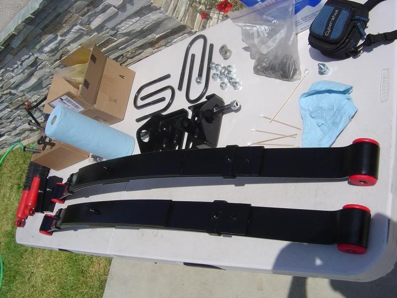

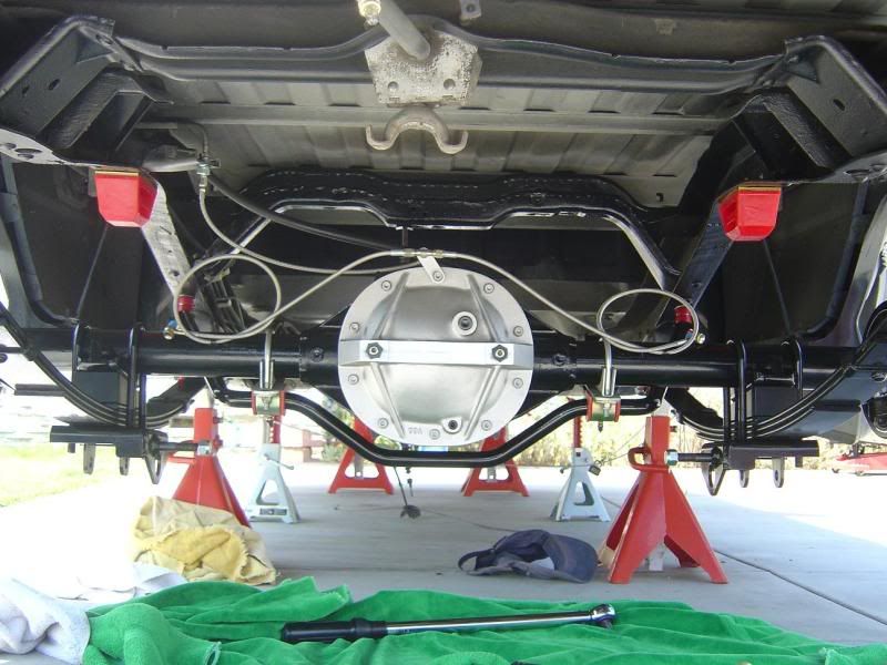

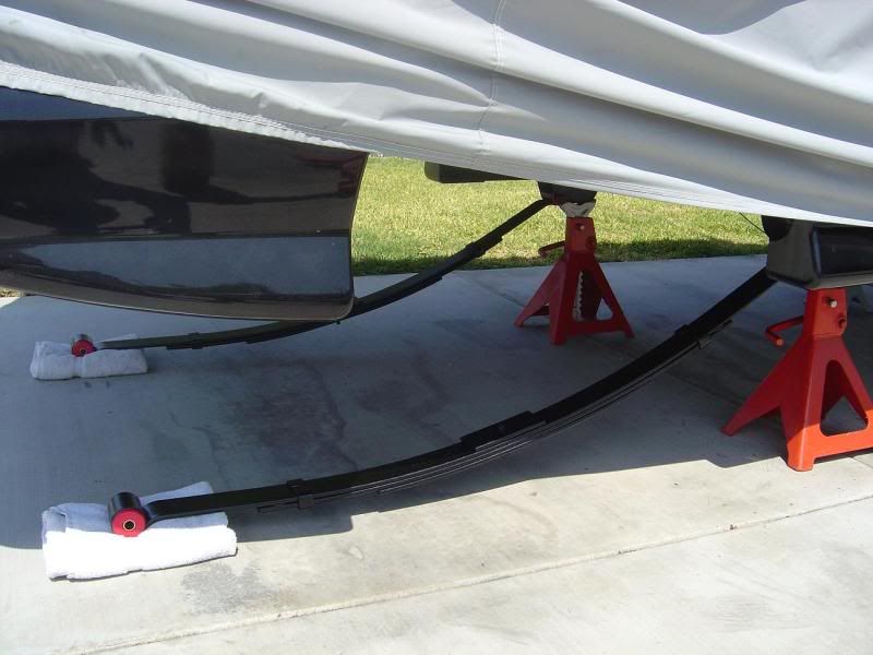

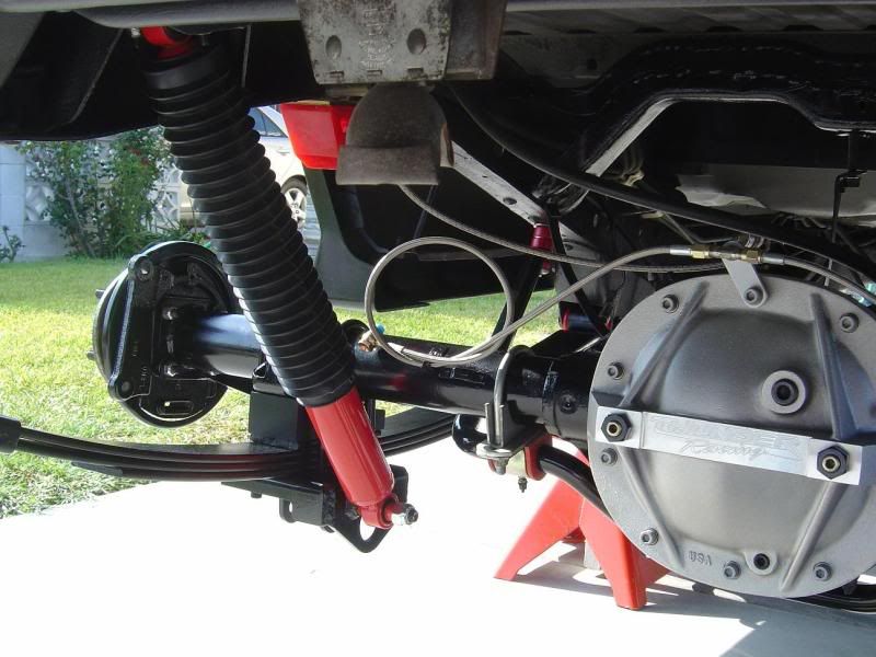

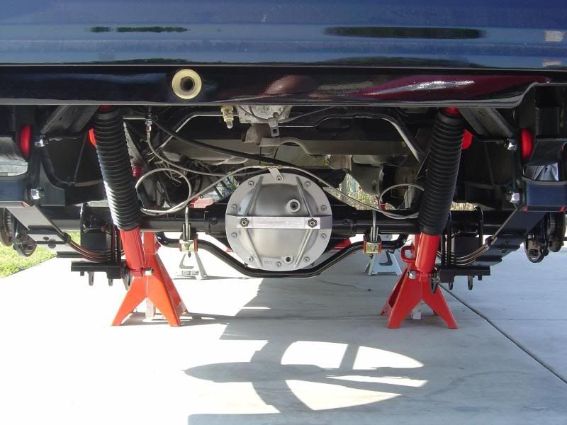

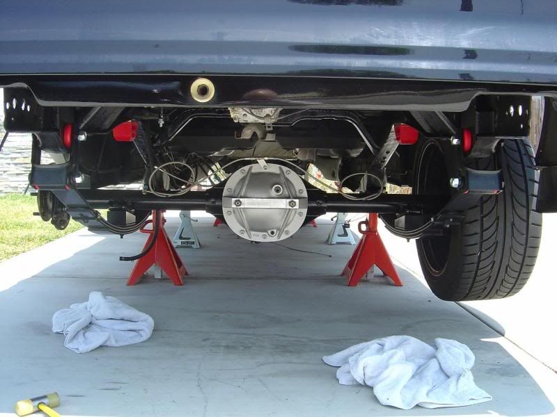

So my pops and I spent about five hours today installing all of the rear suspension:D
We installed the diff, belltech springs, belltech sway bar, monomax shocks, etc.

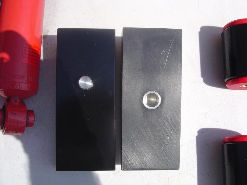

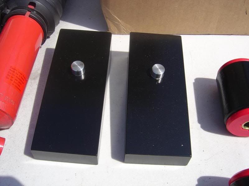

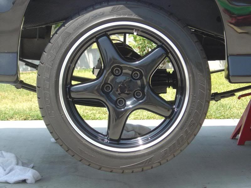

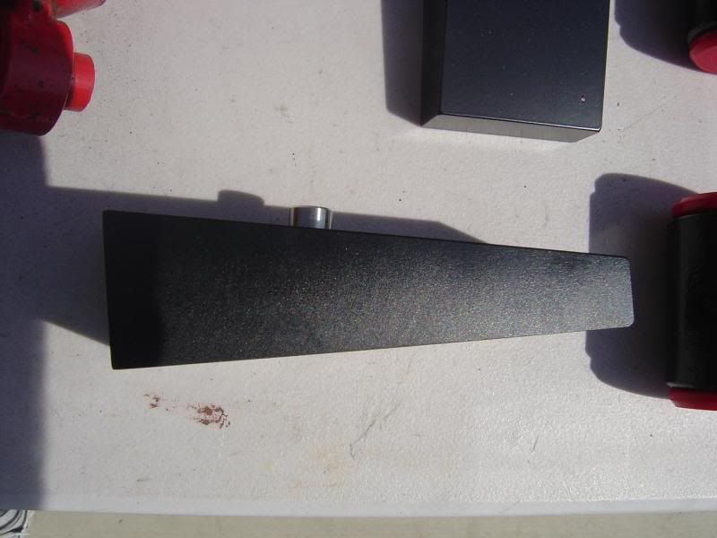

The Davey Z (version 2) custom blocks worked well and I think we have the wheels almost perfectly centered in the wheel opening. They now have a .5" rear offset hole to get the perfect look.
We still have to spray the battle bar tubes and front mounts to finish up the rear portion. The front and rear brake calipers and brackets are going off to the anodizer/plater this week.
Dave P also dropped by to check on the work and show off his super clean 1985 Corvette :tup: Dave P and I also poured one bank of my motor last night with some Hard Blok. We will do the last side tomorrow and then its back off to the machine shop to get finished up.
Next weekend will be fuel system and body bushing time. We are going to spray my 13 gallon tank gloss black, install the RPM double pumper fuel pump setup, and maybe get it installed in the truck. We will also finally get the correct body bushings installed and allign the cab and bed so it sits right on the frame.
Well enough typing, here's the good stuff.
Parts to go in:
Pics of the new Davey Z offset hole, pinion wedged, 1" lowering blocks:
Pics of the parts going in:
Heres Dave P sucking down a Dr. Pepper:
And a final shot of how perfect the wheel looks in the wheel opening:

where can I get a set of those 1" offset wedges??

I don't think you can get a set of those wedges, unless you come on out and put some hours into the build of this truck. They were fabricated in-house by the 'team' that is building this thing.

Thanks bro. I am going to talk to my pops and his buddy Mike to see if we may be able to do a run of these. Stay tuned...

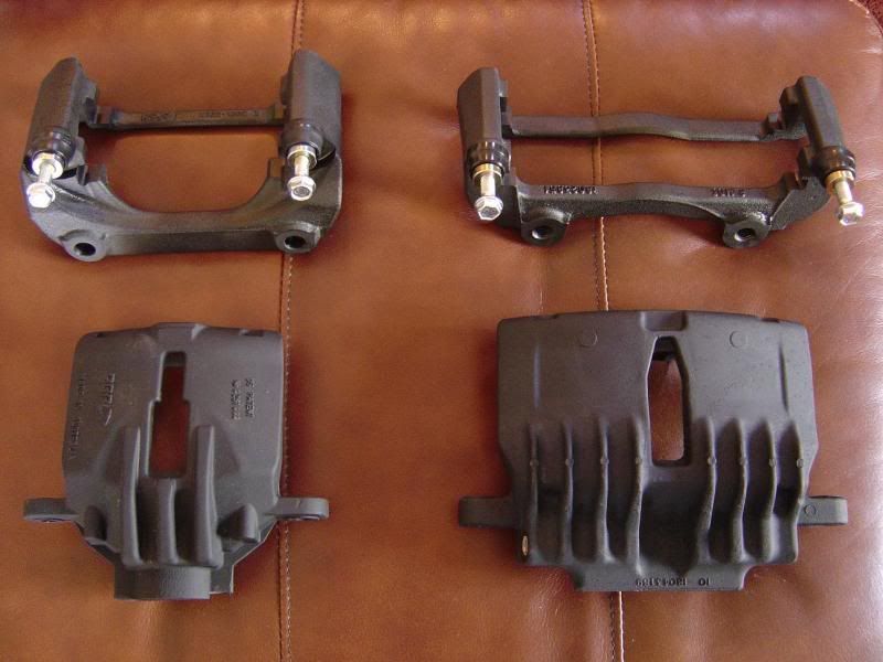

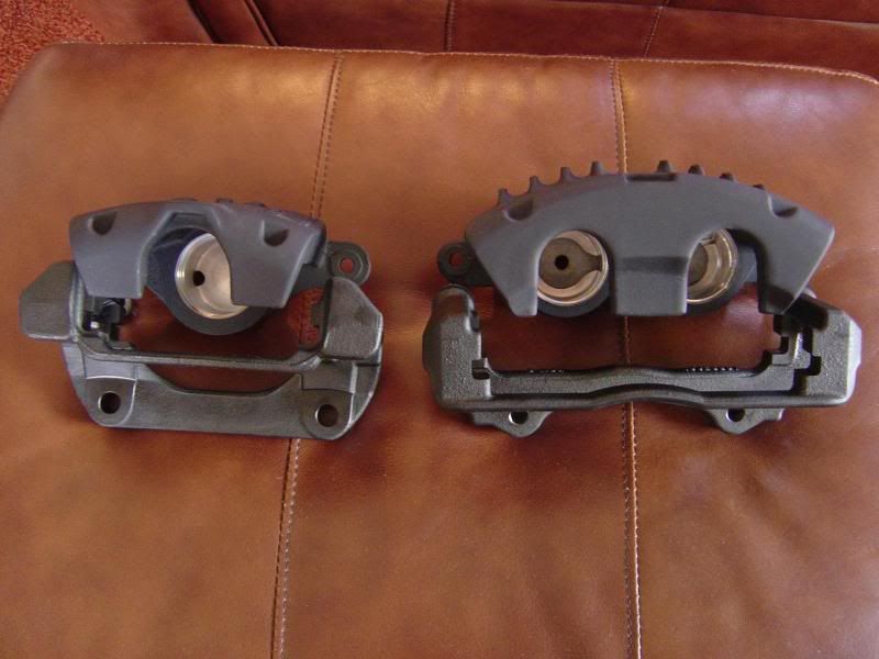

Well i got my calipers and brackets back from the platter and man they look good. The calipers were hard coat anodized black and the brackets were black zinc platted. Now i just need to put them back together. Here are the pics, enjoy.
See ya,
