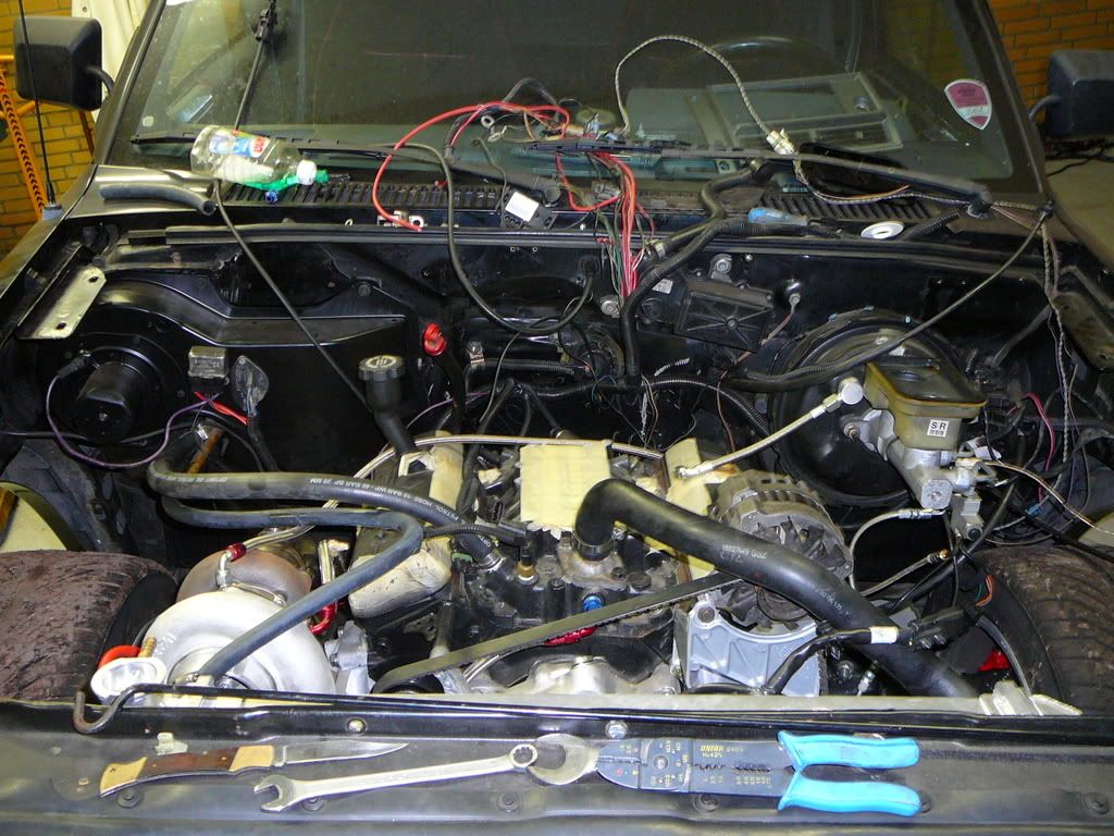

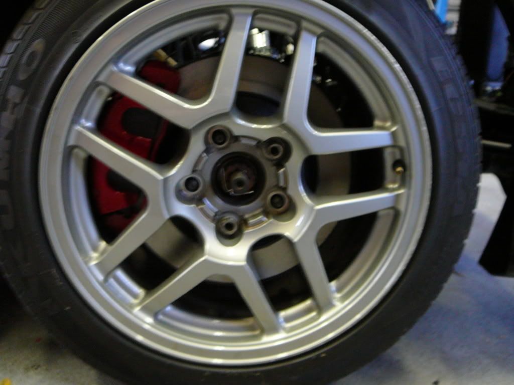

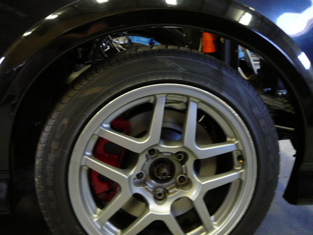

bigger update. here you can see most of the wiring harnass done. the only thing still needs work are the cables at the side of the alternator. since i don't know how ans where i''m gonna mount those.
also done are CBR brackets with the C5 brake stuff. budget coilovers from turbotime.

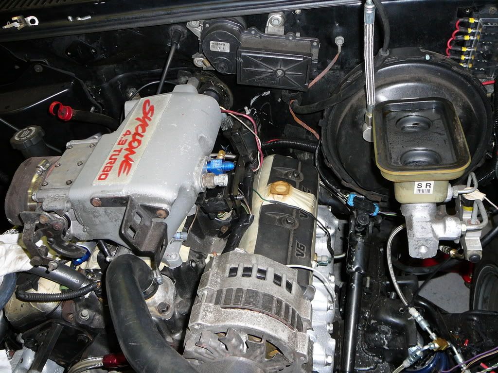

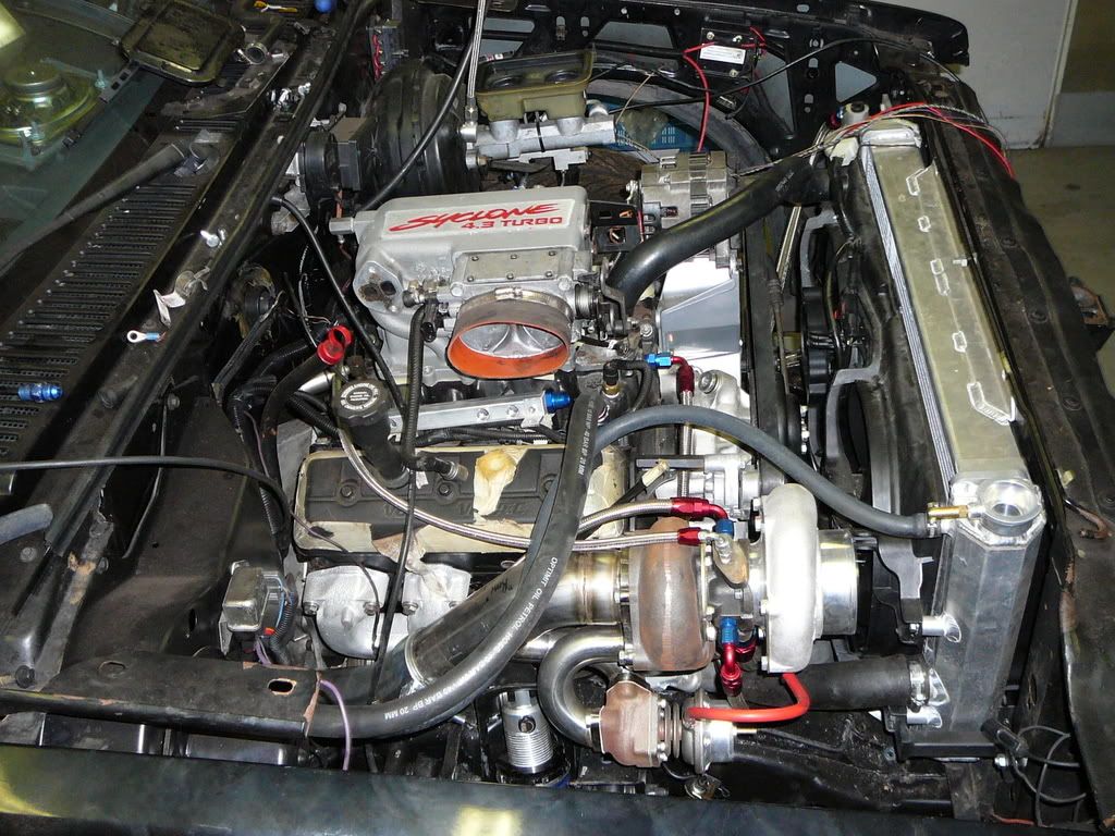

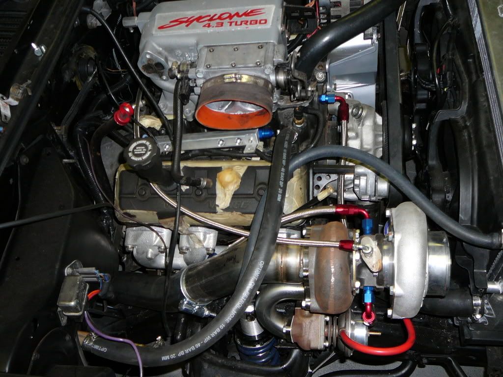

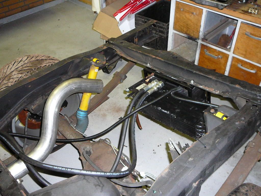

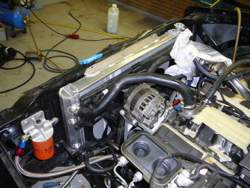

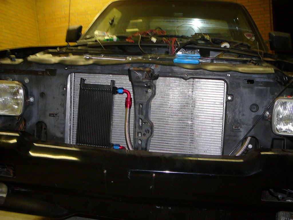

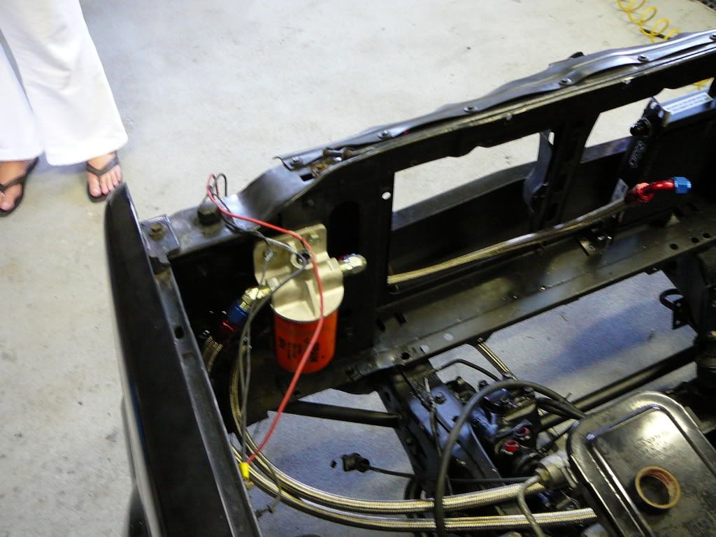

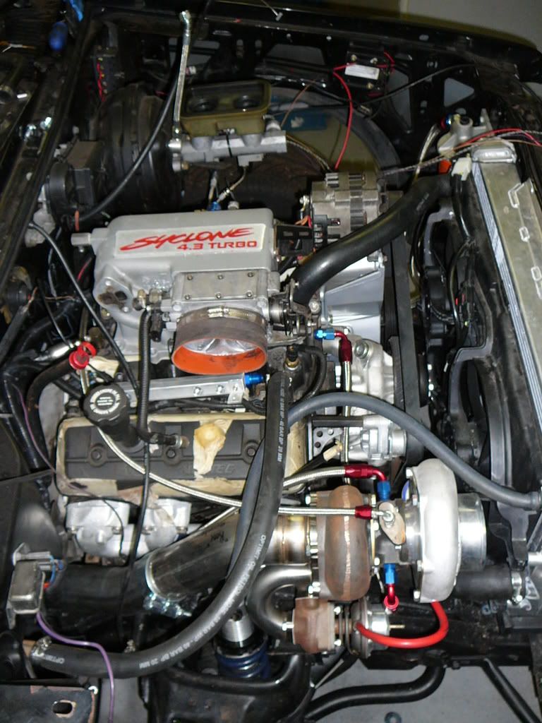

whole lot of update here.

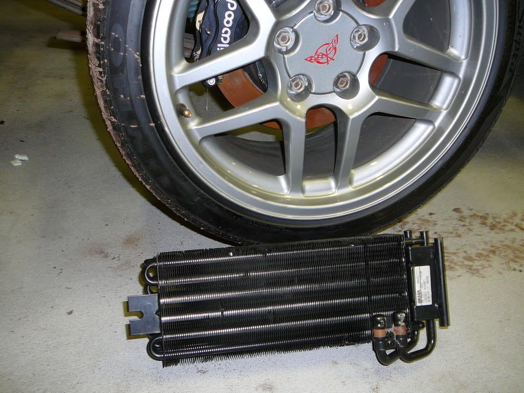

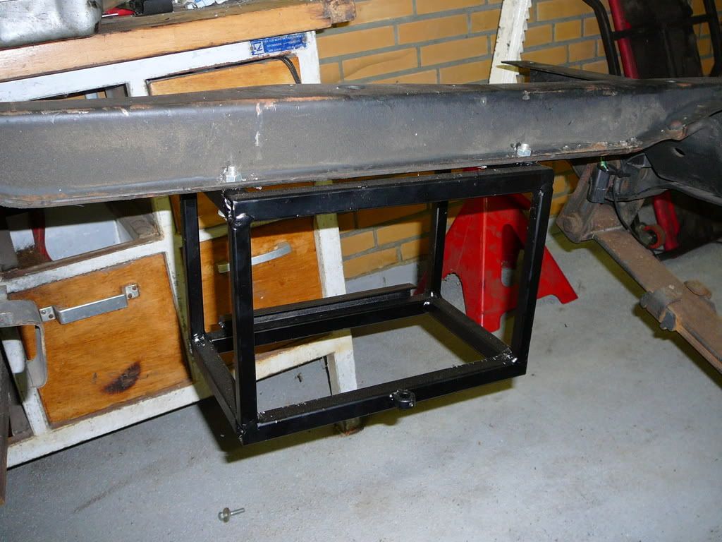

engine is in. made a little box for the battery. nice blingy allu rad. installed with some modification. big ass soon to be tranny cooler. going to be mounted in the back.
budget coil over from RPM. and a blingy ABS delete from the GP! not sure how this will be mounted with the fenders in.
ooooooh.....and a thingy that goes PSSSSSSSSSSSSSSSSSSSSSSSSSSSSSSSSSSSSSSSSSssssssssssssssssssssssssssssssssss
pt 67Dbb ;)
enjoy

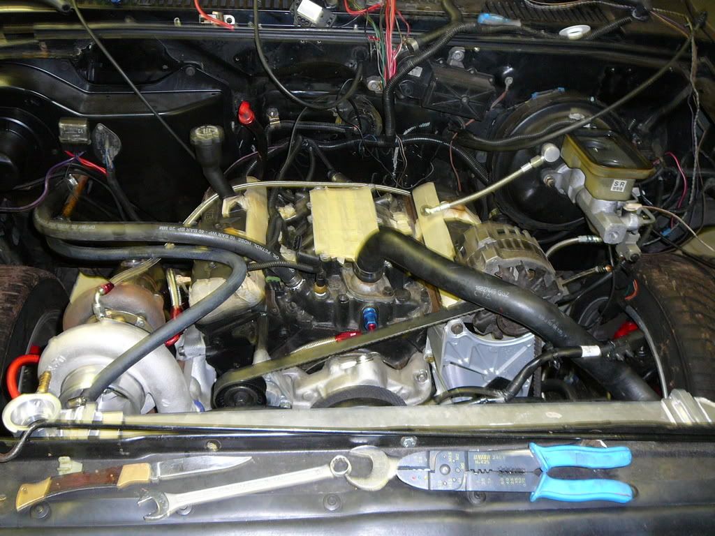

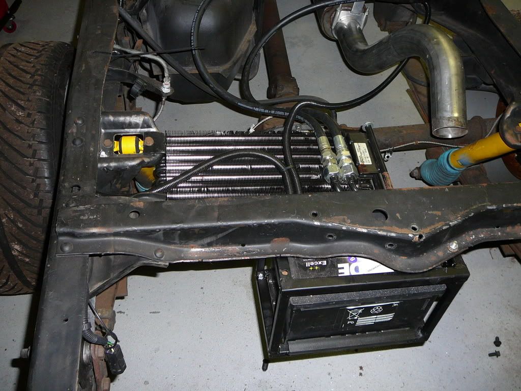

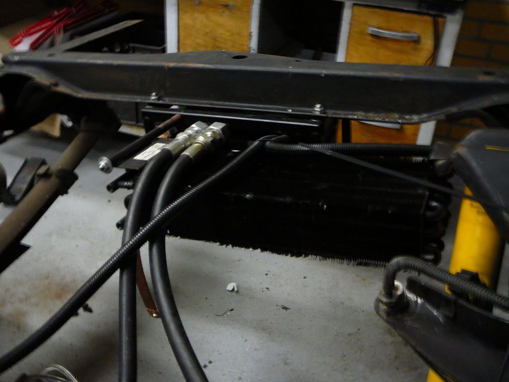

well. short update..
the stock wireing is 99% hooked up. waiting for a set of 65lb injectors. and it's almost ready to get fired up.
for all the peeps with the budget coil overs. and having a hard time to get the wrench on the nut to set the load on the spring. cut the last piece off of the key that comes with it. this way you have enough room to make a turn.
further in the pics you can see my ext. tranny cooler and batt. relocate.

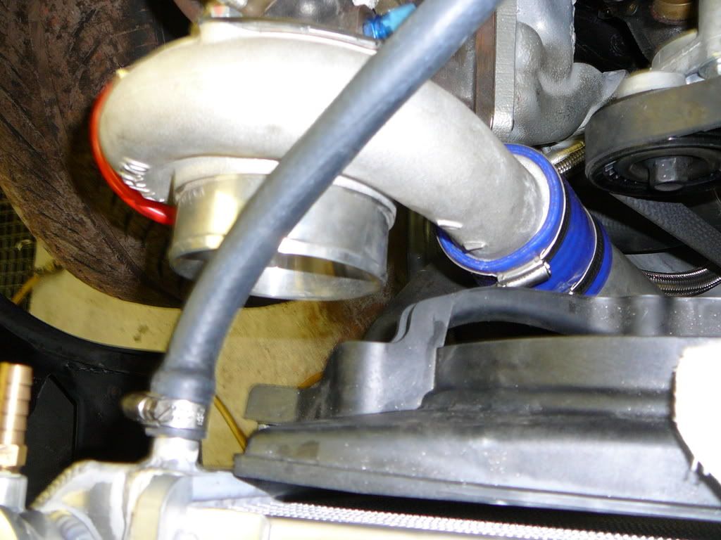

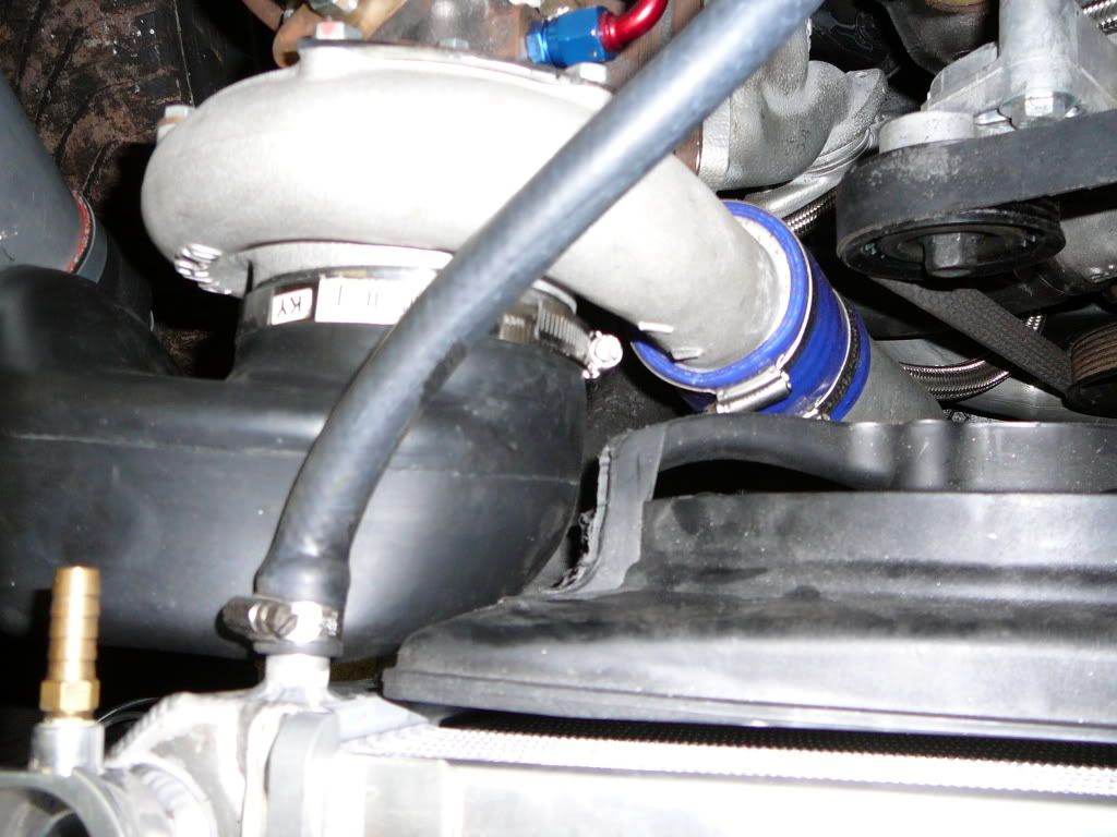

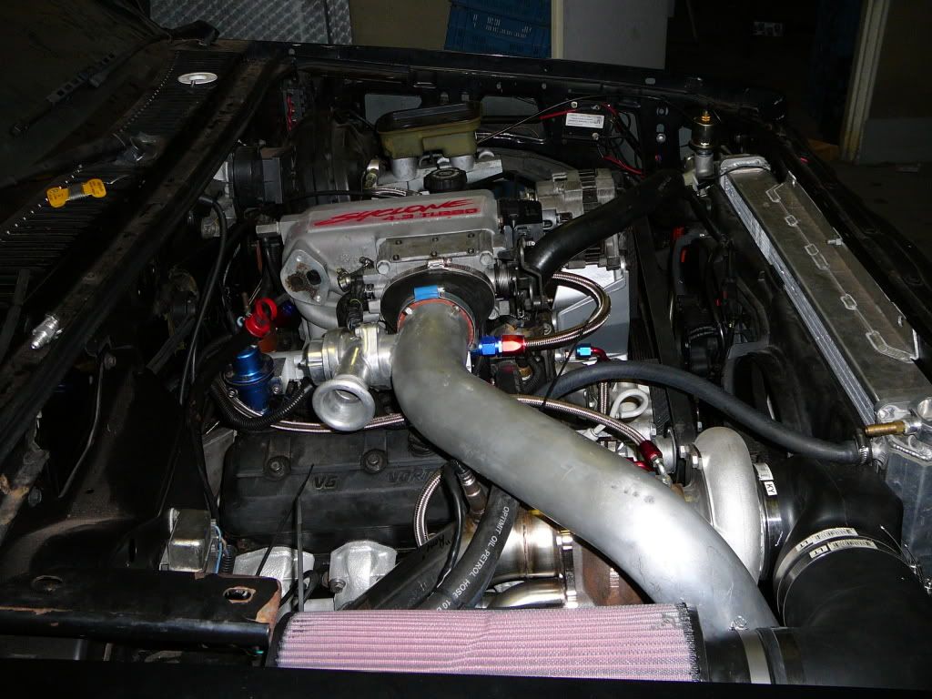

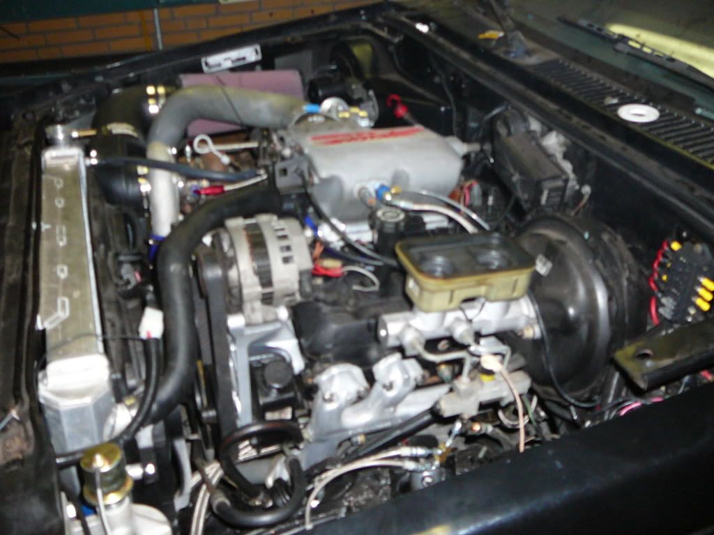

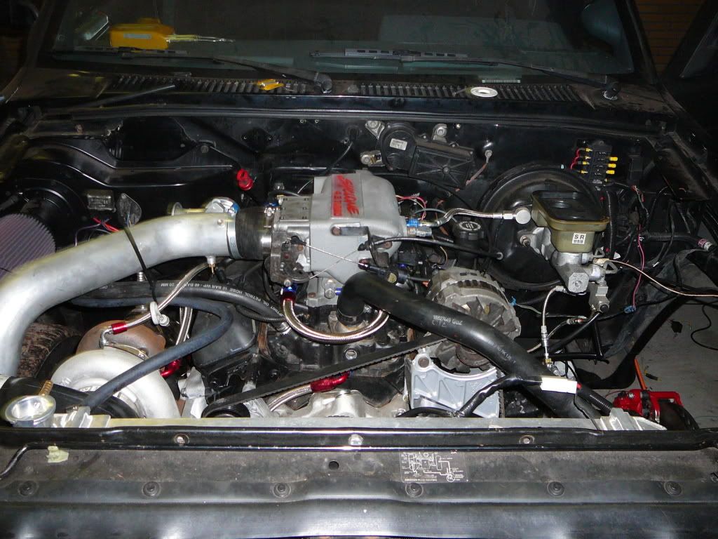

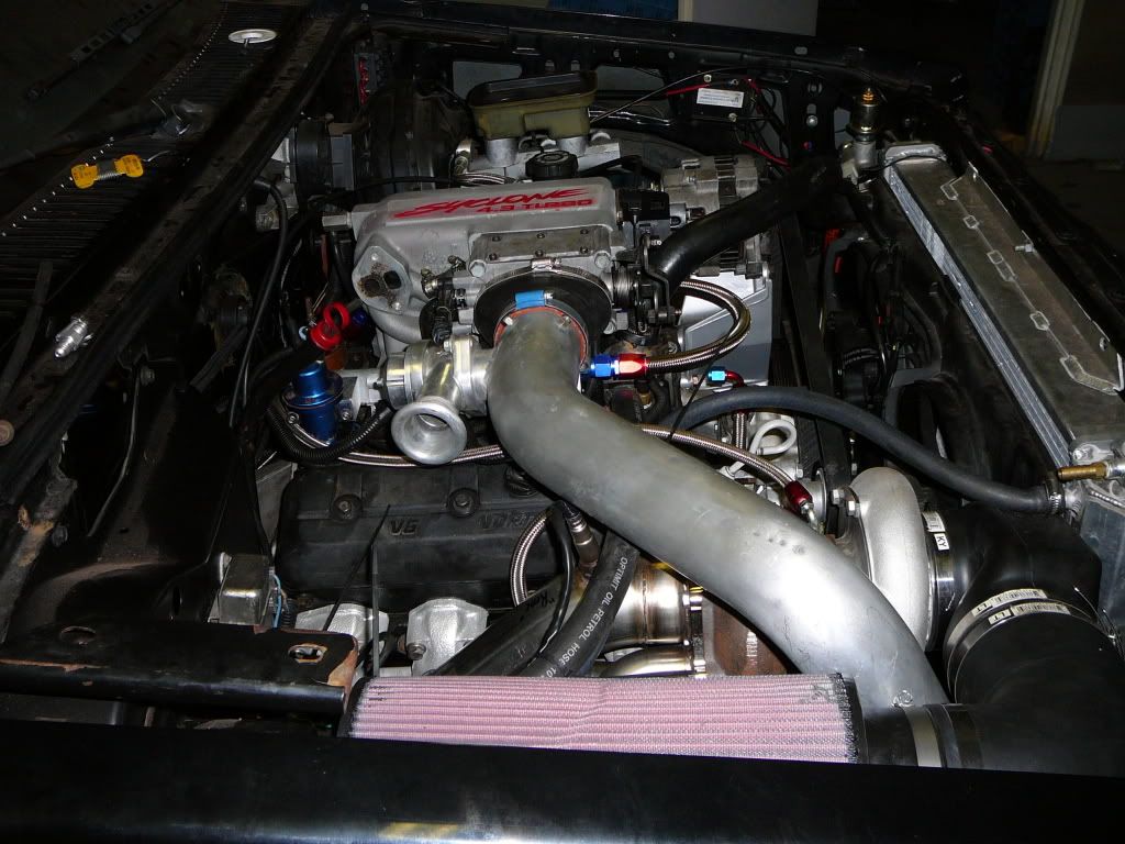

some more pics. with a bit of luck i hope to fire it up this weekend.
i had a tight clearence with the cobra elbow and the ramcharger fin setup so i jad to cut off alot of it.

Re: Syclone project restarted today with pics
Don't you know you are suppose to use DUCT tape instead of masking tape? J/K, that looks like it's going to be a sweet build. Good luck.
bezerk
lol..i really don't know where it came from. and i did all the work during hours i had time to do some work. that was a time to clean everything up. in the same boat now. it runs, still need to deal with some issues. like the fans to hit on controlled by ecm and have an check engine code. datamaster didn't hook up today. hope it will tomorrow after i switched versions. no leaks though :D
